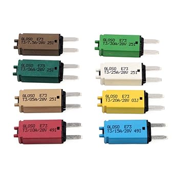

Ugh - I hate these types of problems, I use something like this for troubleshooing so I'm not constantly blowing/changing fuses:
